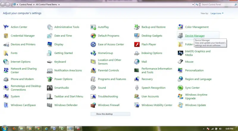

  • Go to the Control Panel from Start button
  • Click on Device Manager

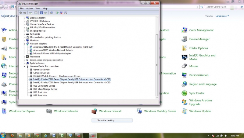

  • Select Universal Serial BUS Controllers. The keyword here is “enhanced”, if you can find it under the USB Controllers as illustrated, you are using a USB 2.0
    • Note: Exact text may vary
