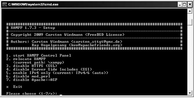

There is a progress for run Xampp. If it is not working then use this progress again. Go to Xampp control panel application and run it then click on setup button and again finish final progress. Then try to run Xampp. When you have done this with the command window will be like this.
