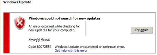

I get this error in my Windows 2008 server machine:
Windows could not search for new updates
An error occurred while checking for new updates for your computer.
Error(s) found:
Code 80072EE2 Windows Update encountered an unknown error.
Get help with this error
Thanks in advance.

According to this URL from microsoft.com, the cause for the error that is shown in your screenshot is caused by a virus.
The virus has probably disabled several services or processes that Windows update needs to function properly.
To remedy the problem without reinstalling Windows, you will have to find a suitable antivirus to scan and fix the damage cause by the virus.
