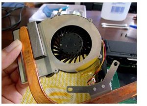

For the processor, you have to remove it. The white thermal fixative of the processor needs to be replaced. In this case, it is advisable to contact a hardware distributor for help. If your PC is under warranty, you may ask the vendor for assistance.
