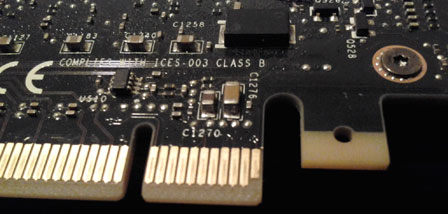

If this doesn’t work, try using a different monitor. This verifies if the problem is with the monitor. If this doesn’t work either, the last to check is the video card. Turn off your computer then unplug it from the power. Open the CPU case then locate the video card. Remove the video card from the slot then insert it to a different slot.
After this, plug the CPU back to the power and turn it on. See if this works. If this doesn’t work, remove the video card again then clean the gold pins with a pencil eraser. Rub the pencil eraser to the gold contact pins of the video card and do it on both sides. When you are finished, finish it off with a clean cloth.
Insert the video card back to the slot and try again. See if this works. If the problem continues, you probably need to replace your video card if you are using a dedicated graphics adapter. On the other hand, if you are using a built-in video card, you need to replace the entire motherboard.
