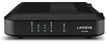

The modem and the router are just the same, but the router has its antenna and the modem doesn't. Can anyone tell me the difference between these two ? Do the modem and router have the same concept, like configuring it?
I also wonder why a modem has RG11 and a Router has RG45. What are all these? What is the advantage of it in computers, laptops, notebooks, iPhones etc.?

A modem/router gives a high rate of internet access. A router performs the routing of packets. Determines the correct path for data to travel between different networks and the data packets to forward to the next device along this path. Essentially, the networks are connected together.
A modem is a 'modulator/demodulator'. Modulate a signal, to encode the digital information. A modem is what you use to receive your connection to the internet via a telephone line or cable.
A router divides this connection, so it can be used on multiple computers. Modem: modulate/demodulate. It also converts analog to digital and digital to analog. Allows you to connect two computers, on a phone line. You can also have a fax machine. For the old dial-up what is obsolete for the most part is a real modem that was often used for Internet access dial-up and ammunition.
If you are a modem of win or real hardware has the ability to mark independently, to anywhere as a phone.
Router: a device of the computer, which is devoted to providing the change between different subnets. Think of it as a divider of subnet with a brain. Can accommodate two or more subnets at the same time. If you purchase a wireless router in the shop, is truly a router. You can put two or more network cards in an old computer of low range and convert it into a router. Network Bridge – A device that allows two different types of physically disparate network, is. For example 'Cable modems'.
Cable Modems" does not modulate or demodulate. They do not convert analog to digital to analog or digital. What they do is convert to Ethernet coaxial cable. The estancias of the digital signal in the whole process. Are a form of network bridge. DSL modem 'Ethernet' turns into a format of digital subscriber line. Then mixed in a higher frequency in the existing phone line. Data is still kept in a digital format. It is also a form of network bridge and not modulate or demodulate. Does not convert digital to analog or analogue to digital.
Why most calls them 'Modems' Cable or DSL? For the same reason, some people call an open end wrench a spanner wrench. It is easier to say. Do not know better. They have been misinformed. That's all for today. I hope that will be of great help to you.
