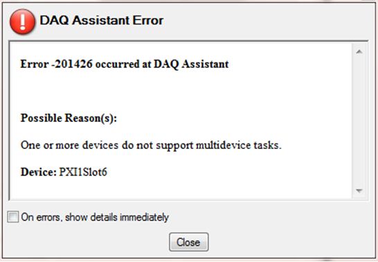

I am using DAQ Assistance Express VI in LabVIEW 7.1. I get this error message when I try to run my program or using CJC Channel on another device.
I want to know the possible reasons of this error?
How can I fix this problem immediately?
Please provide some resolution.
Thanks in advance.
DAQ Assistant Error Error -201426 occurred at DAQ Assistant
DAQ Assistant Error
Possible Reason(s):
One or more devices do not support multidevice tasks.
Device:PXI1S1ot6

Hi Blair,
The error is because DAQ assistance express has a resource conflict.
The solution to the error is as mentioned below:
1) Go to the Measurement & Automation Explorer
2) Expand devices and interfaces
3) Right Click Traditional DAQ devices
4) Select reset drivers for Traditional DAQ
5) This will release the resources previously reserved for another task
6) After these settings restart the program, it will work efficiently without errors
