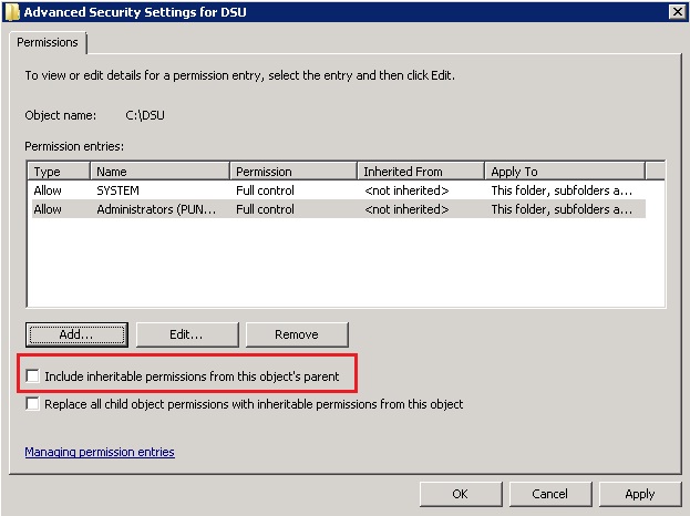

The main cause of this event was due to unconfigured 'Storage Location' of DLO (NUDF) that means it need proper permission.
Just check the TFS security and the Share permissions on the folder that is defined as the Storage location of DLO (NUDF). Also ensure the following configuration below;
Inheritable Permission from Object's parent
Share Permissions on the root NTFS folder defined as the NUDF
Administrators (group)      Full Control
DLO Service account:      Full Control
Everyone:                        Full Control
Security Permissions on the root NTFS folder defined as the NUDF
SYSTEM:                        Full Control
Everyone:                        Read and Execute
Do take Note: To avoid conflicts with permissions, the inheritable permissions from the parent folder should not propagate to the NUDF folder.
