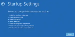

Boot your system in Safe mode.

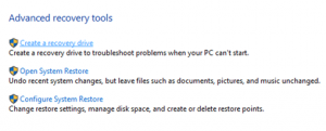

If you had created a Restore point when your system was working fine, at that point you use the features of Windows.
