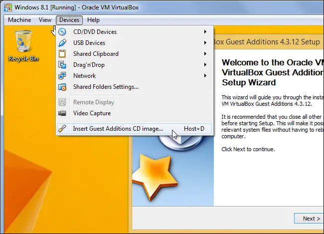

When you create a shared folder, the guest operating system accesses a file or a folder as if it was accessing it from a shared folder on a network. If you are using VirtualBox, you need to install Guest Additions. For example, in your case, start the Windows XP virtual machine then go to Devices then select “Insert Guest Additions CD image”.

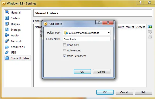

Follow the instructions to install Guest Additions. Once it is installed, click Machine, Settings, and select Shared Folders.

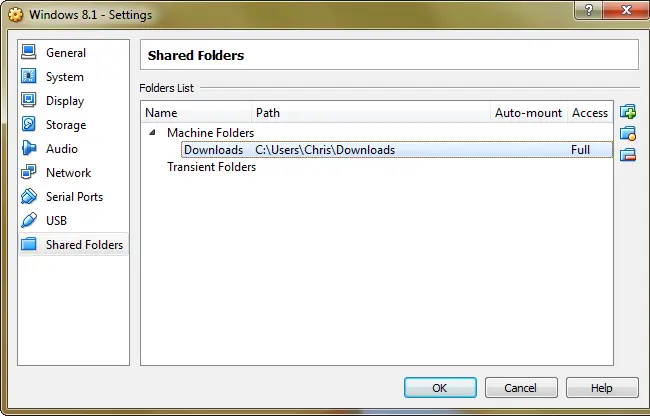

Click the Add button and select Add Shared Folder. Navigate to the location of the shared folder you created and select the folder. Check Make Permanent then click OK all throughout. And that’s it. Just copy the file to the shared folder whenever you want to share files with the virtual machine.
Note: there are two types of shared folder: the Machine Folders and the Transient Folders. Machine Folders are permanent folders that will be shared until you delete them. The Transient Folders are temporary folders and will be removed when the virtual machine is shut down or restarted. When you check Make Permanent, the shared folder becomes a Machine Folder.
By default, all shared folders are Transient Folders until you make them permanent.
