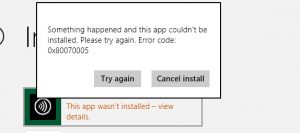

Why I am getting error code 0x8007005 when I try to update the drivers or apps? Does anyone the reason behind this problem? Please help me to fix it.

I think you are referring to error code “0x80070005” and not “0x8007005.” You may receive error code “0x80070005” when you try to install a Windows Update but you lack permission. To install a Windows Update, you need both file and registry permissions which are available in administrator accounts but not on limited accounts. This error is also called the “ACCESS DENIED” error.
