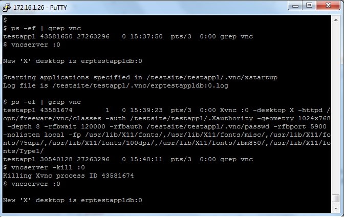

I guess you use UNIX as operating system = 2 You must install Virtual Framebuffer X Server = 2 sided = X Server virtual buffer frame can render to a region instead of the graphical screen, this server X well suited to systems running certain classes of applications with X11 rendering techniques for creating graphics files = 2 Try it first in your Unix = 2
$ xclock
You should see a digital clock = 2
We had the same problem with HP UX = 2 We used the Unix patch (PHSS_30871) and the problem was solved.
