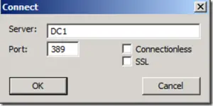

Then, click on connect.
Type the server name and click on OK.

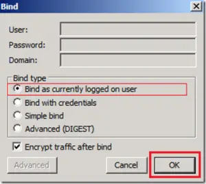

After that, click on Bind.
Then, click ok.

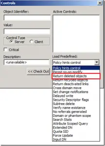

Now, select Options menu and then click on Controls.
Then, in the drop-down menu, select “Return deleted objects.”

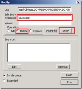

Then, browse to the container of Deleted Objects and locate the Deleted Objects that you want to recover. Right click and then select Modify.
Now, input “isDeleted” and select Delete under Operation and press Enter.

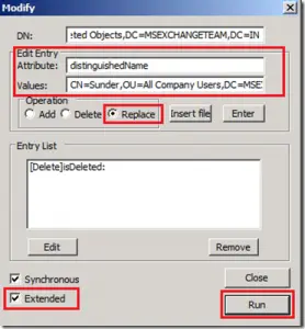

Then, type distinguishedName and type the original DN of the object in the values. Select the check box Extended.
Under Operation, select Replace and again press Enter. Finally, click Run.
Object restored successfully.
