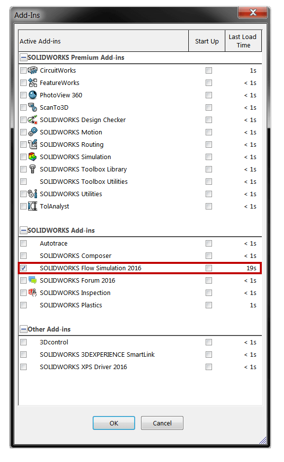

In SolidWorks, the load times of add-ins normally should read less than a second. If there is an additional second delay for an unknown reason, this is the time to check. One of the common problems with SolidWorks is a slow startup. In this case, you need to check the load time of your add-ins.
SolidWorks includes a column called “Last Load Time” located on the right of the Add-Ins dialog. There are several reasons for the load time delays of add-ins like unregistered add-in DLL files or your antivirus is currently scanning the DLL file the time the program is loading.
If you experience a slow starting SolidWorks, try adding the program’s installation folder to your antivirus or internet security’s exclusions. If this doesn’t work, uninstall and reinstall that particular add-in.
