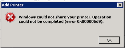

When you try to share the printer you might get the following error:
Windows could not share your printer. Operation could not be completed (Error 0x000006D9)
This problem is related to integrated Windows 2008 R2 firewall. To be able to install and share printers on the Windows Server 2008 R2 you have to enable the Windows Firewall.
