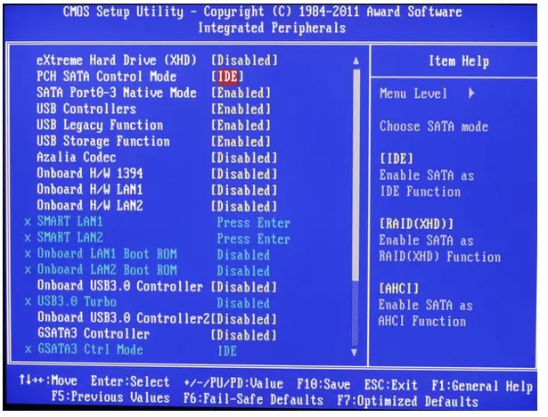

If that doesn't solve the problem, you may look for the menu button located on the front or the sides of the computer, select 'Screen' scroll down then select 'Degauss'. Select 'Ok' to apply the setting then wait for it to tune, which will also involve shaking.After you are done with that, you may reboot the computer and see whether the problem is solved. If the problem still persists, open the bios by pressing 'Delete' repeatedly when the computer is booting and adjust the settings/tolerance for the Electro Magnetic Interference interface. Then restart the system
integrated peripherals CMOS utility setup
This should solve your problem, thanks
