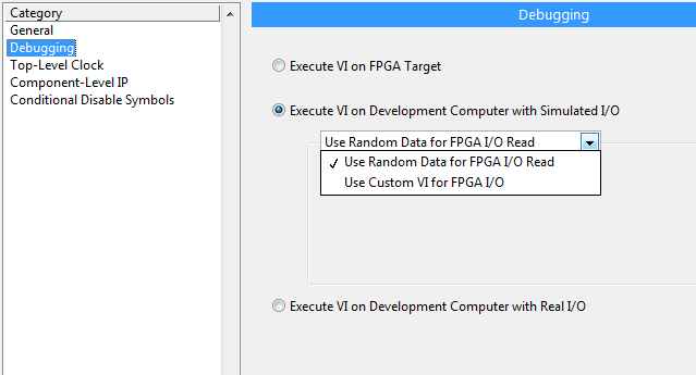

The problem is arising because there’s no physical IO lines present on the host PC. In order to solve this issue, you have to configure simulated data.
1. From Project Explorer, right-click on the FPGA target.
2. Go to Properties >> Debugging.
3. In “Execute VI on Development Computer with Simulated I/O” section, two options are available. Select “Use Random Data for FPGA I/O Read”.
After this fix, such error won’t trouble you again for sure.
