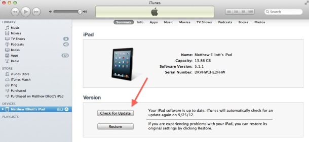

Now, you have the USB cable for iPhone and also the installed iTunes in your desktop. Connect your iPhone to the USB port of your computer using your USB cable. If the iTunes doesn’t run automatically, run your iTunes in your desktop manually.
Inside your iTunes, you will see your device on the device group on the left side pane of the window. By default your devices is selected and if it is not, select your device as you can see on the image below.
On the right pane, you will see below the iPhone image and details the button “Check for Update” and “Restore”. Click the restore button to restore your iPhone into its original state. WARNING: all applications and data installed to your phone will be lost. If you have the chance or way to back-up your iPhone, back it up before proceeding.
Do not turn-off your iPhone or disconnect. Just wait until Restoration is complete.
