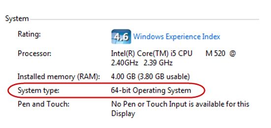

For PC’S open start menu-> right-click on my computer -> properties -> system type-> system

3)Â Â Â Â Â Download WMDC depending on the bit-ness of your system.
Windows Mobile Device Center for Windows 32-bitÂ
Windows Mobile Device Center for Windows 64-bit

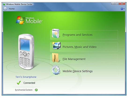

4)Â Â Â Â Â Run the downloaded extension.
5)Â Â Â Â Â Follow the onscreen instructions.
6)     You will be informed about the installation by a message stating ‘Device driver was installed successfully’.
7)Â Â Â Â Â Press finish.
8)Â Â Â Â Â Open start menu and search WMDC and sync your mobile device with the system.
