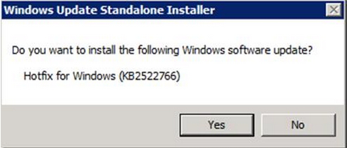

1. Firstly, click on OK to proceed the installation process. Next, you will be prompted by this following message:
MPIO drivers are unable to operate correctly

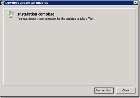

2. Click Yes to install KB2522766 and follow the installation steps. Once it has completed, you will be asked to reboot your machine.
Download and Install Updates complete

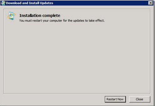

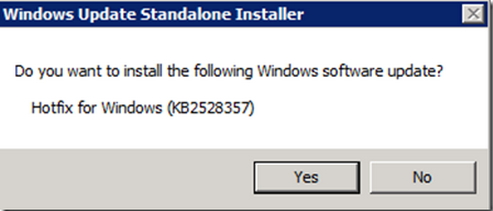

Next, please install KB2528357 similar to step 1 and 2 above.
KB2528357, which is a nonpaged pool rupture Download and Install Updates complete

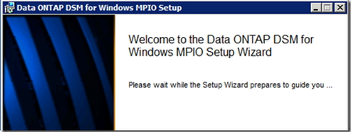

After you have reloaded your computer twice, now you are able to go about installing MPIO DSM 3.5
Able to go about installing MPIO DSM 3.5
