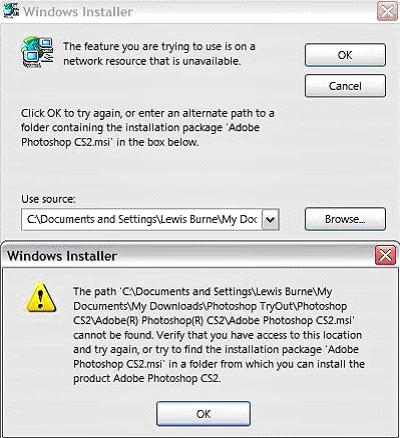

Photoshop also shows another error message:
Windows Installer
The path C:Documents and SettingsLewis BurneMy DocurnentsMy DownIoadsPhotoshop TryOutJPhotoshop CS2Adobe(R) Photoshop(R) CS2Adobe Photoshop CS2.msi' cannot be found. Verify that you have access to this location and try again. or try to find the installation package Adobe Photoshop C52.msi in a folder from which you can install the product Adobe Photoshop CS2.
OK

The problem with your Adobe Photoshop is only with a missing installer file, Adobe Photoshop CS2.msi. Maybe after your early attempt to install this application you made a disk cleanup on your hard drive that’s why all of the temporary installation files were gone and deleted from your system.
If you have the installer disc for Adobe Photoshop CS2, load it on the optical drive and try installing it again.
