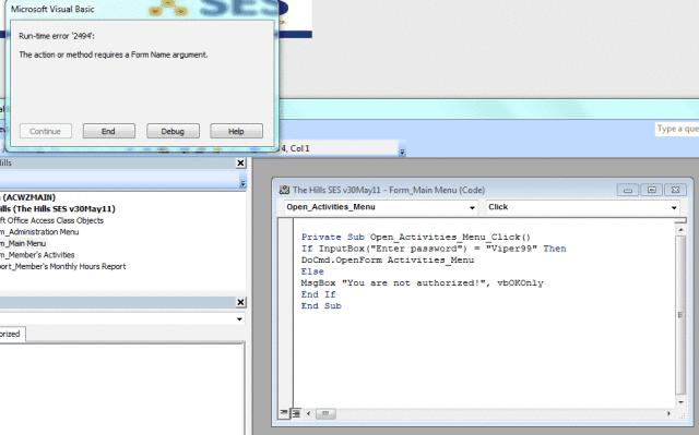

Private Sub Open_Activities_Menu_Click()
If InputBox("Enter password") = "111111" Then
DoCmd.OpenForm Activities_Menu
Else
MsgBox "You are not authorized!", vbOKOnly
End If
End Sub
The issue is the DoCmd line where I get a message
Run-time error '2494':
The action or method requires a Form Name argument
Your help is very much appreciated,
Thank you.

Hi
Here is the solution for your problem
Just write the code as follow assuming the command button name is Command42
Private sub command42_Click()
 On Error Goto Err_command42_Click
      Dim stDocName As String
      Dim stLinkCritieria As String
If input ("password") ="thepassword" Then
        stDocName="Form Name"
        DoCmd.OpenForm stDocName,,,stLinkCriteria
Else
        MsgBox "You are not Authorized", vbOKOnly
End If
Exit_Command42_Click:
       Exit Sub
Err_Command42_Click:
      MsgBox Err.Description
      Resume Exit_Command42_Click
End Sub
and It will work with you
the idea here is to create a button to open form normally using the wizard then you do some changes on it to put the condition of password and make the restriction
