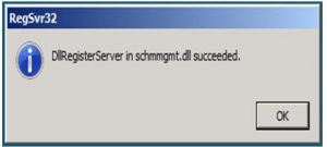

  • Click on start, and then search for the run.
  • Type regsvr32 schmmgmt.dll
  • Click OK.
  • A pop-up message will appear which will confirm your registration of schmmgmt.dll. Click OK

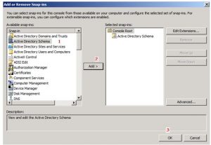

  • Click on start> run, type MMC hit on ok.
  • Click on file> then click on Add/Remove snap-in
  • Select Active Directory Schema, click on Add and then hit on OK.

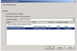

  • Click on change active directory domain controller, by right clicking on the Active Directory Schema.
  • Choose your schema master role holder from the domain controller. Hit on OK.

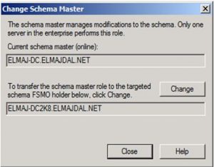

  • In the console root right click on the Active Directory schema and then select operation master.

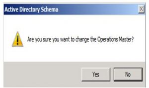

  • On the change schema page, choose change button.
  • To confirm your role transfer, click OK.
And the role will be transferred.
