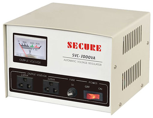

If you are referring to the AVR or the automatic voltage regulator, you shouldn’t get scared because that’s normal when plugging the power cable to the power. The main job of the power supply is to maintain or keep a steady voltage and avoid power fluctuation that can damage the computer. This is important during power outage.
Automatic Voltage Regulator
When the power goes back, the power supply can prevent power surge from damaging the computer because it limits the output to a certain voltage only. When you plug the power cable of the computer to the power supply, you should see a spark because the internal power supply of the CPU begins to work.
