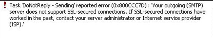

I was setting up MS Outlook for the first time for my Web Mail in the office.
However, I got this error message (see below) while sending and receiving mails.
Task 'DoNotReply' - Sending' reported error (0x800CCC7D)
Task 'DoNotReply' – Sending' reported error (0x800CCC7D) : 'Your outgoing (SMTP) server does not support SSL-secured connections. If SSL-secured connections have worked in the past, contact your server administrator or Internet service provider(ISP)'

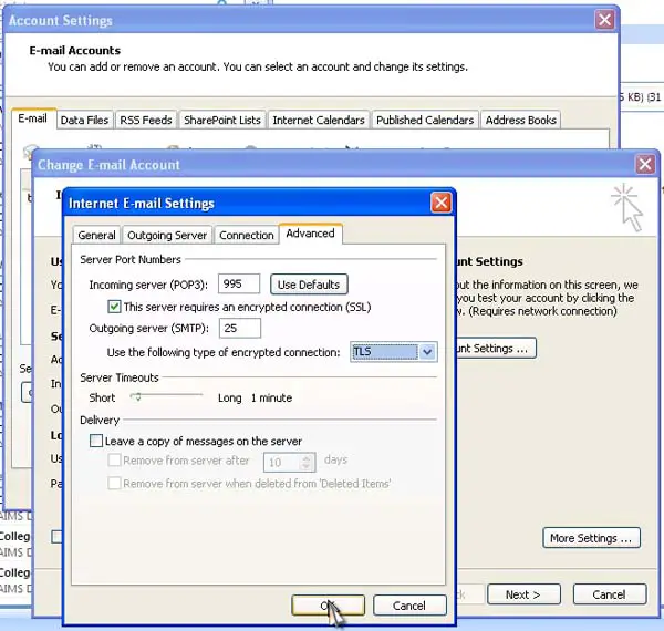

Actually your outlook is not configured properly. All you need to do is check you SSL and TLS settings. You have not told me about windows and Ms Outlook versions. Actually this may happen in Ms Outlook 2003 that does not start TLS command.
For the solution you can perform following tasks.
  • Go to tools and click Email Accounts.
  • Click on change and go to more settings and click advanced tab.
  • Disable Encrypted TLS tab.
  • Outlook Express user can do it by going to accounts, properties and click advanced and just uncheck SSL Encryption for outgoing messages.
