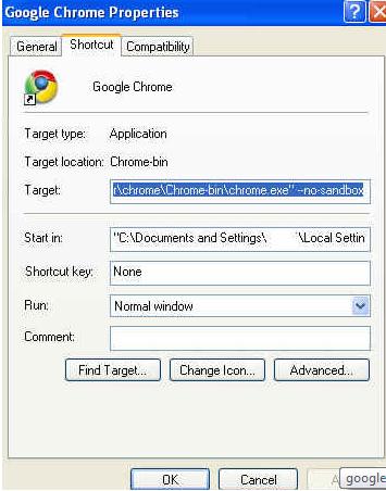

  • Right click on the Google Chrome icon and go to Properties
  • In the target field, right after the quotation (") mark, put a space then add –no-sandbox (make sure there are two dashes (–) before no)
  • Click Apply and then OK
  • Run using this shortcut

  • Right Click on the Google Chrome shortcut.
  • On the drop down Menu choose Properties.
  • On the Google Chrome Properties window, click on the Shortcut Tab.
In the Target text field, type "–no-sandbox" in the end or right after the end of quotation mark (“). Also make sure to put a space between the quotation mark and the word –no-sandbox. If you’re using any Symantec software or Antivirus, and the above process didn’t work, you have to make some registry edit.

An easy solution is to run Google Chrome with –no-sandbox (with two dashes before "no"). To run the that option, edit the property of the Chrome program and add the option to the end of the "target" line (after the path to the chrome exe).
  • Right click Google Chrome and click Properties.
  • Click the shortcut tab.
  • In the target text field, add a space and then add – no – sandbox ( with two dashes before "no") right after the end of the quotation mark. Make sure that there is a space between the quotation mark and the two dashes.
  • Then run your Chrome.
