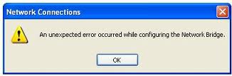

I am a new user of Internet. When I tried to connect on internet via dial-up Internet connection the following message shows:
“An unexpected error occurred while configuring the Network Bridge”.
I do not have any idea why the message shows?

Local area connection or a dialer has this configuration where you can set it into bridge mode. In a normal process, this icons should not be in this settings for unforeseen reasons, it'll probably been set by accident or mistake. This is the cause of the problem, if this function is miss configured.
When connecting to dial-up connection, the dialer has to be set and configure properly. when an error message is pop-up, AN unexpected error occurred while configuring the Network Bridge is caused by settings.
Right click on the network dialer, then un-bridge the network. This will let you connect to the Internet once the dialer connects to the server via dial-up connection.  Onc
