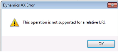

I have installed Dynamics AX 2012 and installed Excel 2010. Now I am trying to remove the following error message. I get this error when I click on the Connect Button in Dynamics AX tab. Help me to resolve this error immediately.
This operation is not supported for a relative URI.

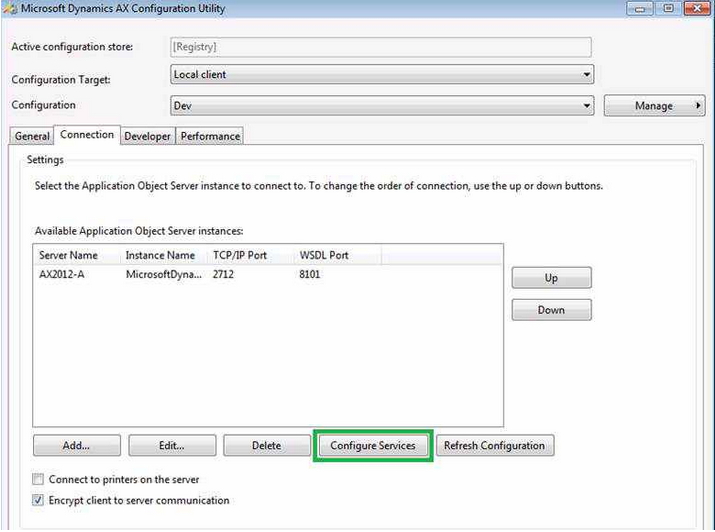

Step 1: Open the "Microsoft Dynamics AX Configuration Utility".
Microsoft Dynamics AX Configuration Utility to configure services

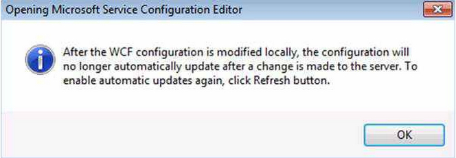

Step 2: Then open the "Microsoft Service Configuration Editor".
After the WCF configuration is modified locally

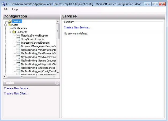

Step 3: Open the "WCF Configuration Editor".
Configuration of Client Endpoint
