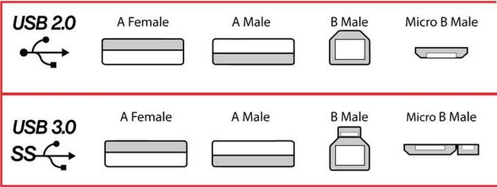

1. Check Specification of both USB device and PC. We can’t use a USB device with version 3.0 if our PC only has a USB port that has version 2.0 and vice versa (I have included an illustration how to check if USB is 2.0 or 3.0).
It’s either look for another USB device that’s compatible with your PC or look for a PC that supports your USB device. You might also wanted to check if the USB device is working with other PC or another USB device is working with your PC.

USB port that has version 2.0 and USB port that has version 3.0
