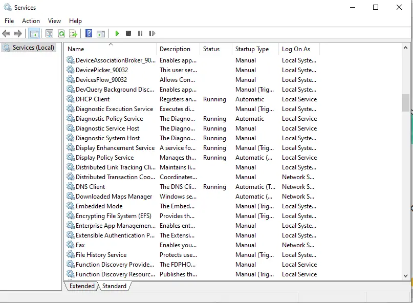

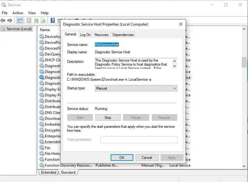

If Method 1 did not help follow the method below –
a. Press Windows + R.
b. Type services.msc, and press enter.
c. Find the following three services in the list – Diagnostic Policy Service, Diagnostic
Service Host, Diagnostic System Host.
d. The startup type of services are listed below –
i). Diagnostic Policy Service – Automatic.
ii). Diagnostic Service Host – Manual.
iii). Diagnostic System Host – Manual.
e. If you find that the services are not running or the startup type does not match, double-click on the service, start the service or change the startup type.
