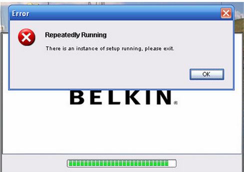

When I try to install the Belkin UPS Power Management software I am getting this error message "Error: Repeatedly Running. There is an instance of setup running, please exit".
There is an instance of setup running-Belkin UPS Power Management software error
Error:
There is an instance of setup running. Please exit.
I need to solve this error. Please help me. Thanks.

Hi Donna,
Just delete the folder and reinstall again.
1. Start> computer.
2. Drive C: ( local disk).
3. Find the folder Belkin_APM_setting_up.
4. Remove the folder.
5. Reinstall Belkin UPS Power management program.
Hope this will help you.

Belkin UPS Power Management Software “Error: Repeatedly Running”
Turn off your Belkin UPS and start again. Then try to install the software again. If you are getting this error message again, then:
1. Go to My Computer
2. Double click C: (Local Disk)
3. Search Belkin_APM_Setting_Up
4. Delete this folder
5. Reinstall the program.
If it does not work, then download the new Belkin UPS software from the link below:
http://www.belkin.com/us/support
Thanks
