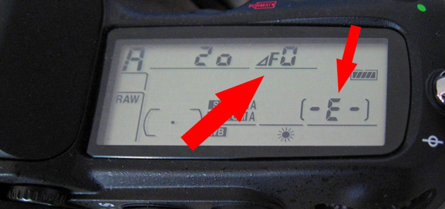

  •    Continuous (-E-) Message:
Image result for Continuous (-E-) Message: NIKON CAM DSLR
This error reflects that you don’t have any memory card in your camera. If you already have one inside the DSLR, try taking it out and then mounting it back inside. If it fails, you have to try another card. If even after this the problem doesn’t go, contact Nikon services.
