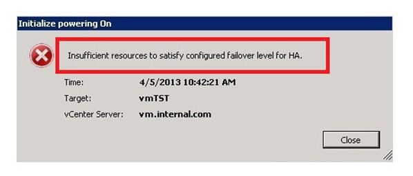

When you try to power on to a new VM, insufficient resource error might occur. It means some resource is not present in any of the devices. VM knows about it but is not sharing the exact location. How to solve insufficient resources to satisfy configured failover level for vsphere ha?
Answered By 0 points N/A #200488
To Satisfy Configured Failover Level For Vsphere Ha.
PROBLEM CAUSE:
The cause is vSphere HA admission control. If any host is down, then insufficient resources will be available for restart. Ensure that the right admission control policy is selected. Disable the admission controls to avoid such errors. SOLUTION OF THE CAUSE:
