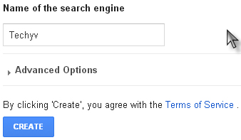

In “Name of the search engine”, a label or name is automatically created as you enter your site in the previous step. You can keep it or change it if you want a different name for your search engine.
google-custom-search-engine-second
When you are finished, click “CREATE” to generate your custom search engine. Once the custom search engine has been successfully created, the next screen should look something like this.

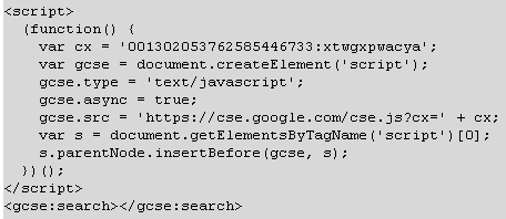

You are now finished building your Google custom search engine. Now, to put that on your website, click “Get code” and you should get something like this.
google-custom-search-engine-fourth
Copy the code in thesection in your HTML page where you want the search box and the search results to appear. To further customize the search UI, go to Custom Search Element Control API for the full documentation.
