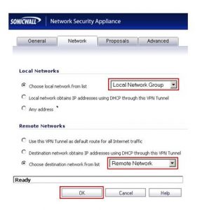

I have a Sonicwall TZ 215 and 2 ISPs at work. I even have fail over setup and dealing properly aside from our website to website VPN affiliation. we tend to use our VPN to firmly connect with our off-site VOIP supplier.once a fail over happens, all of the workplace phones lose affiliation to the VOIP server.
So what’s the most effective thanks to get this working? will / ought to I setup a second VPN?

You don’t want 2 tunnels. you would like your VoIP supplier to permit the tunnel to come back from your backup ISP address, as well. Also, check that you have got your IPsec VPN policy set sure to use Zone WAN below the advanced settings, and NOT a selected interface.
You won’t be able to produce 2 site-to-site tunnels to identical destination. you ought to see if the VOIP supplier will tack together your fail-over WAN address as a secondary peer for the tunnel.
