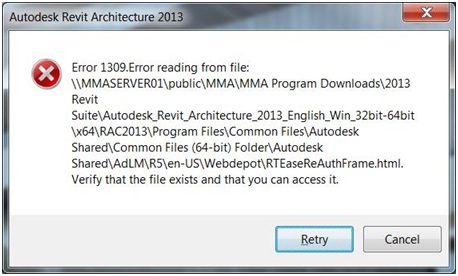

I tried several times to install Revit 2013 but I encounter the below error message each time. I tried several trick but in vain including windows updates, turning off firewalls and antivirus and uninstalling C++. I have run out of options, please help.
Autodesk Revit Architecture
Error 1309.Error reading from file:
\MMASERVERO1publ icMMAMMA Program Downloads2013
Revit
SuiteAutodesk.Revit_Architecture_2O13_EngIish_Win_32bit-64bit
x64RAC2O13Program FilesCommon FilesAutodesk
SharedCommon Files (64-bit) FolderAutodesk
SharedAdLMR5en-USWebdepotRTEaseReAuthFrame.html.
Verify that the file exists and that you can access it.
Retry Cancel

There are two possible issues that might be causing the error.
First is incorrect path. Open the path written in the error log via your explorer and check if everything's fine there. If not, you will have to recreate the folder manually.
Another possible issue is that your path is exceeding 260 characters. Rename the folder Autodesk_Revit_Architecture_2013_English_Win​_32bit-64bit to something short and it should work.
