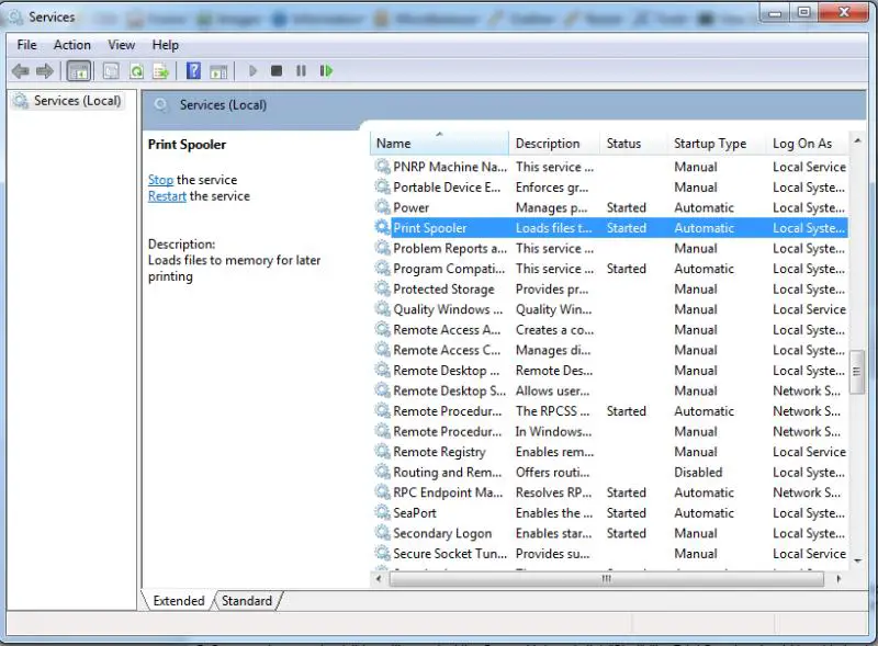

I have a Toshiba Satellite A660D. I have not changed the windows operating system 7.
When I try to initiate the impression tail (cola) manually, this error message appears:
Services
Windows could not start the Print Spooler service on Local Computer.
Error 1053: The service did not respond to the start or control request in
a timely fashion.
I cannot decide what to do to solve this problem.
Please someone has more ideas on this, to tell with key words.
Print Spooler isn’t working properly
Here is your solution:
1. Go to Component Service Option and Find Print Spooler.
2. Right Click on Print Spooler and Stop the Service.
3. Go to C:WindowsSystem32spoolPRINTERS and Delete everything.
4. Again go to Component Service Option, Find Print Spooler and Start the Service.
5. Restart your PC and try to print again.
Hope it will work for you.
Thanks!
Hello Zacharytyshawn,
Can you please try this method.
Click "Start and Type in Services.msc, then press Enter.
2. Browse down and look for Print Spooler.
3. Right Click then select Properties to open another window.
4. Select the Log On Tab and un-check the "Allow service to interact with desktop" feature.
5. After unchecking the setting, click on the "General Tab and Click Start.
This method should be able to solve your problem and eliminate the error you are encountering.
