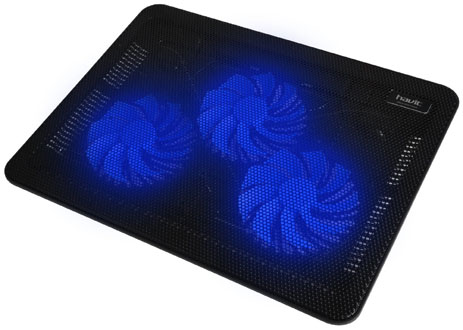

The best option to fix this and prevent the laptop from suddenly shutting down without disassembling it is to purchase a laptop cooling pad such as this one: HAVIT Laptop Cooler Cooling Pad.
