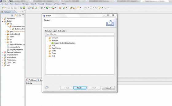

step#1 Right click on project package from left side.
step#2 Click Export then select export android application and click next.
step#3 keep the project name default selection.

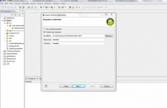

step#4 Select "Create new keystore" radio button and click browse for location.
step#5 Browse any location you want and type the file name without extension, here I choose C:UsersquayumDesktopselimselm
step#6 After selecting location, enter password(any password)..then click on Next.

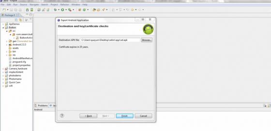

step#8 Select Destination location and APK file name(you can use the default apk file name or change it with .apk extension),
Step#9 after that click Finish, that will take a while and close the window.
—-Here your apk file is created as desired location—–
