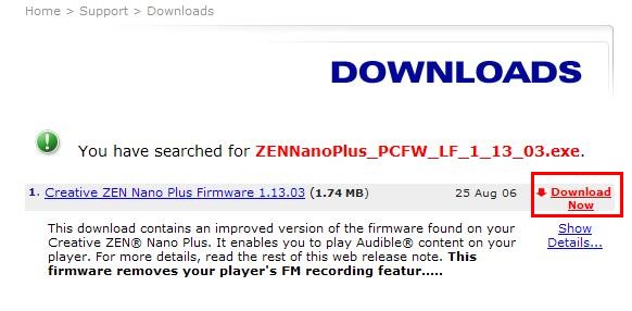

1. The firmware of your device may need to be updated. To do this you need to have the latest firmware update for your player.Â

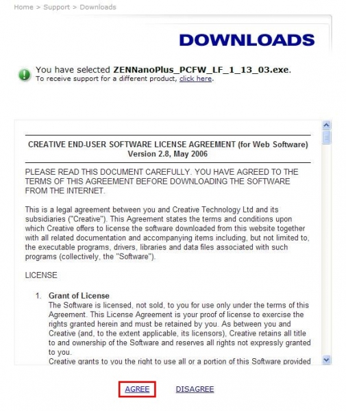

Click on Agree on the License Agreement page.

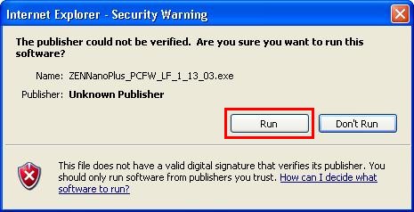

Click "Run" button.Â
On the Security Warning window, click on "Run" button again.
