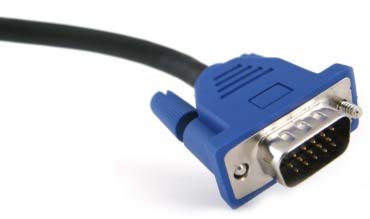

If that thing happened to your monitor after moving your speakers, then maybe the video cable connecting your monitor to your CPU which can be found at the back of the CPU is not connected properly. This happens if the cable is not fixed to the video port using the built-in screws.
The video cable or video connector has built-in screws on both sides that can be used to fix it to the video port so it will not move in case you touch the cable or you move your monitor. It is normal for the monitor to display odd colors when the video cable connected to the video port has slightly moved.
To fix the colors of your monitor, push the monitor cable to the video port and then fasten it to the CPU using the built-in screws on the sides.
