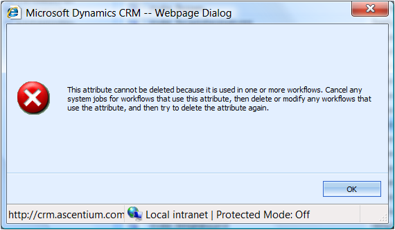

We desire to remove numerous characteristics from an object we fashioned (Employee).  Typically, this is an incredibly direct issue with Microsoft Dynamics CRM.  You merely eliminate the area from the Form and Grids. From there, utilizing the Entity Editor, you then pick the characteristic and click “delete”.  In our incident, the characteristics in discussion were being utilized by workflow.  Regrettably, the error report you get from CRM is not very useful. Can you tell me how to stop their use in workflow and remove them?
Thank you very much for your service.
Error:
Microsoft Dynamics CRM — Webpage Dialog
This Attribute cannot be deleted because it is used in one or more workflows. Cancel any system jobs for workflows that use this attribute, then delete or modify any workflows that use the attribute, and then try to delete the attribute again.

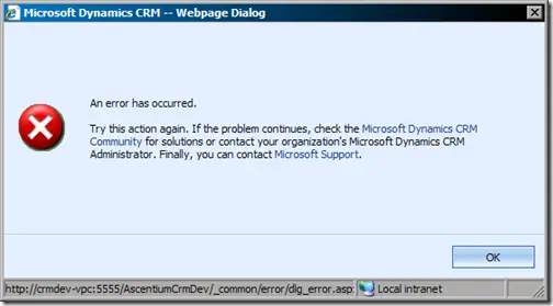

You will get this error message:
This is because, as a safety measure the CRM delete attribute process only deletes part of it and not all. If this happens to you, just open the Workflow editor using the User Interface, remove the dependency and “re-save” it.
The workflow UI and other XMLs will get updated with the new changes. You should be able to publish your workflow again without problems.
