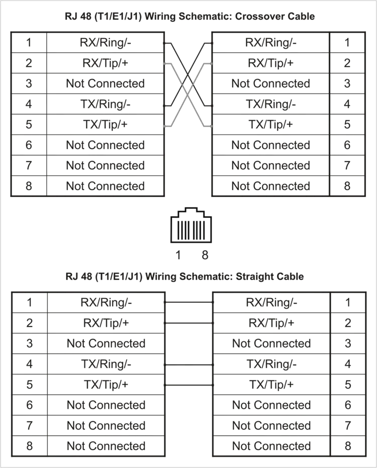

The wiring can be simply done using the diagram. There are two ways you can do the connections. First is the crossover and second way is a single direct connection.
Now, points to remember are –
1. There are eight wires, and we are not using the wires at 3678 places.
2. We will use 1245 for the transmission where 1 is Receiver ring, 2 is receiver tip.
3. 4 is transmitter ring, and 5 is transmitter tip.
4. When receiver, is connected to the transmitter of the biscuit, then it is called a crossover connection.
5. When the receiver is connected to the receiver, then it is called a simple connection.
6. In a crossover connect 12 to 45 and in simple connect 12 to 12.
7. It can be more clearly seen in the diagram.
