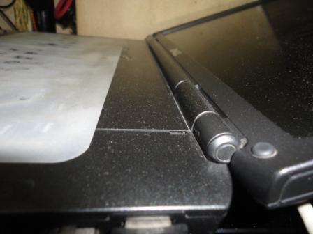

1. Move your lid back as much as possible like the picture below.
Process to open Laptop

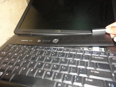

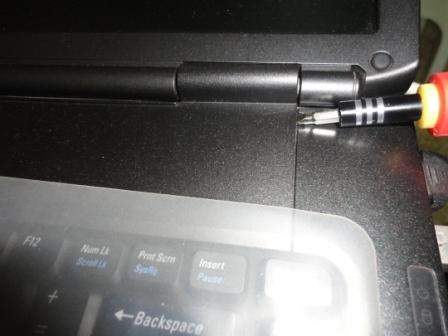

2. Notice the keyboard latch notch.
Open laptop front panel
3. Gently place a flat headed screw driver or a plastic rod on the notch.
open the laptop by screw

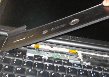

4. Press the latch upward. Do it very gently otherwise you could break the latch. When the latch is unlocked, try to open it with your hand.
open front cover of the laptop

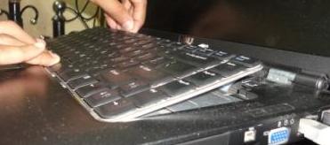

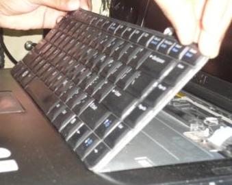

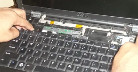

6. After the screws are done, place your hand on the keyboard like the picture below.  You should try to push the keyboard forward with your right hand and bring it upward with your left hand. Be careful when you bring upward your keyboard as the connection wire lies under the keyboard and it's really short . So don't  pull it very close, that will tear the wire.
step replace the keyboard

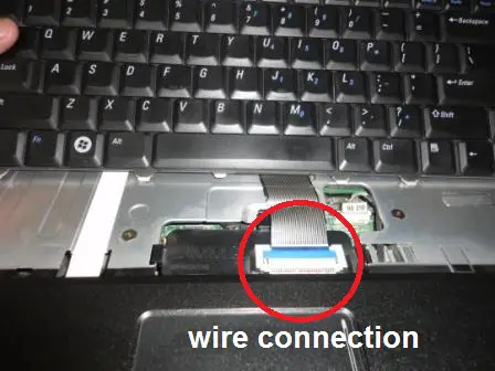

7. Place the keyboard like in the picture. Notice the connection wire.
carefully disconnect the connection wire

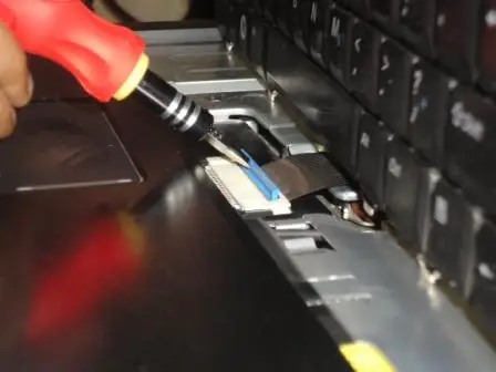

8. Open the connection lock,
connection Lock
and gently pull the wire out.
pull the connection lock
