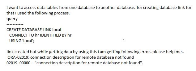

I Am Trying To Access The Database, But It Shows 02019 00000 Connection Description For Remote Database Not Found. Help Me With This Error.
02019 00000 Connection description for remote database not found error appears with the description message ‘ORA-02019: connection description for the remote database not found.’ The error usually occurs when the user does not use the proper schema for the database using db links. The solution to fix the issue is using ‘tnsping entry of the target db.’
The user should keep in mind the following points:
  • GLOBAL_NAME in the listener. ora and ping again (b4 that ora11 DB LINK must be created and see whether it is public or private.’
  • SERVICE_NAME in tnsnames.ora (the value should be the sever side service_name value)
