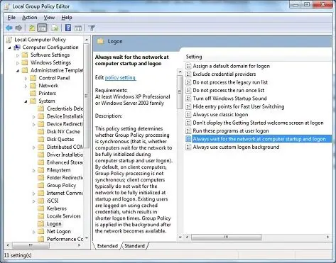

c. You have to go to the following location – Local Computer Policy\Computer Configuration\Administrative Templates\System\logon
d. Right-click on the option shown in the picture.
e. Go to properties.
f. Go to the Settings tab.
g. Click on Ok.
h. Restart your device.
