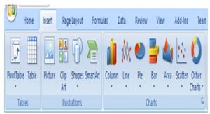

To add error bars and standard deviation to Excel chart, you need to generate graph first.
To add a graph to the sheet use insert option.
In the charts pane uses the required graph you need.

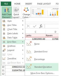

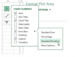

When the plan appears on the sheet, right-click on the chart and choose error bars option.
Error bars will bring a new side option pane with more choices, select standard deviation.
You can also insert the standard deviation to the sheet by using add chart element option.
