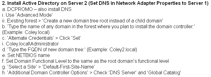

Next process is to install Active Directory on server 2. Setup the network adapter to use the DNS on server 1.

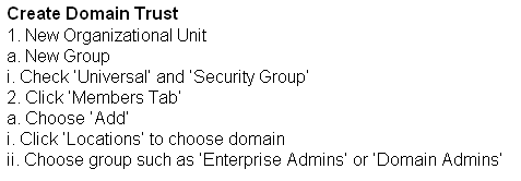

The last part is to create domain trust.
