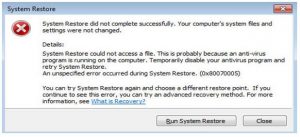

How I can remove the bug of unspecified error occurred during restore 0x80070005. Why I am facing this issue. Please help me.

This is system restore fault of your computer.
Make sure to start the computer in safe mode.
Uninstall your antivirus software from your device and then try again.
Your system file is corrupt. To fix it, change device protection settings or clean boot your device.
Install Hotfix application.
Always do a system restore in safe mode to avoid this problem.
Try to run SFC, write SFC /Scan now in command prompt.

If you tried restoring your computer to a previous date using System Restore but you receive an “unspecified error” during the process, one possible cause is your antivirus. Antivirus programs are known to interfere with this process preventing the entire operation to continue. Try disabling your antivirus temporarily and then try restoring your computer again. See if this works.
If this failed to work, try restoring your computer in Safe Mode. Restart your computer then press F8 before the Windows logo appears. In “Advanced Options Menu” or “Advanced Boot Options” screen, select “Safe Mode” then hit Enter to boot. When you’re in Safe Mode, try restoring your computer again and see if it works. If this doesn’t work either, try checking your system using the SFC tool.
It could be a problem with one of your operating system’s protected system files. Click “Start,” “All Programs,” “Accessories” then right-click “Command Prompt” and select “Run as administrator.” In the command prompt window, type without quotes “sfc /scannow” then hit Enter. This may take some time to complete so just wait. When it is finished, try restoring your computer again.
