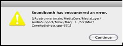

I have Mac PC with OS X 10.6.4 and Adobe Soundbooth CS5. When starting Soundbooth and open Looks3_AE.plugin I got an error:
"Soundbooth has encountered an error.
[/Roadrunner/main/MediaCore/MediaLayer/VideoFilterHost/Make/Mac/../../Src/AEPluginVideoFilterModule.cpp-107]"
Or
[/Roadrunner/main/MediaCore/MediaLayer/AudioSupport/Make/Mac/…/…/Src/Mac/CoreAudioHost.cpp-551/
Looks3_AE.plugin is a plug-in for AE that has a Magic Bullet Looks. I tried to reset the settings for Soundbooth but this error keeps prompting. How can I get rid of this AE plug-in? Help please.

Answered By 1065 points N/A #109807
Error on soundbooth CS5: crashes on start
The possible reason why you are getting this error is because of some CS4 plugins are preventing Soundbooth to run correctly. Try going to the media core folder: /Library/Application Support/Adobe/Common/Plugins/CS4/MediaCore and then check which plugin is causing this error.
